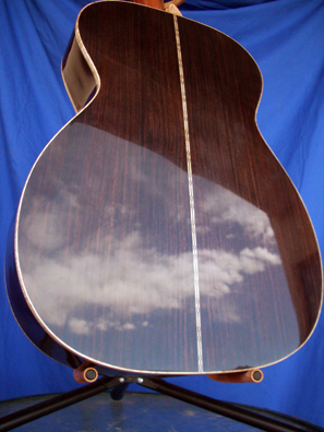

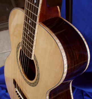

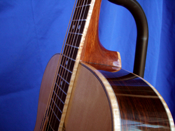

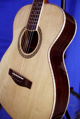

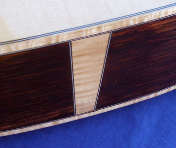

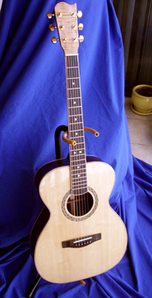

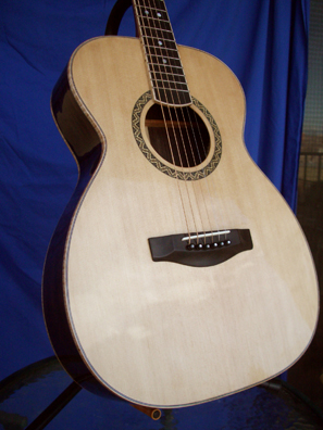

The following photos are the result of my class with Robbie O'Brien. My first guitar project of any kind. Mostly made from the LMI standard kit, with some decorative stuff of my own.
I've done some rough carpentry and some very small furniture and general house projects before, but this was as detailed as I've ever gotten with woodworking and its a completely different world.
After many attempts, I am finally somewhat happy with the photos, so I hope they translate well.
Its a pre-war Martin OM style.
Spruce top, Rosewood back and sides, Curly maple highlights...
I still find it difficult to take photos of glossy finishes, but I think after reading a few articles, I've got a little better handle on it. I didn't have any black background to shoot onto, so this blue sheet had to do.
Its the KTM-9 finish, by the way. Some brush coats and some HVLP coats.
-j.
edit: I'm sure someone will notice, so I'll bring it up myself- The nut is not quite done. That will be remedied in the next couple weeks.j.Brown38732.5922106481

Wow. Very nice! How did you do the top bracing? How's the sound?
Pat
PostPosted: Sun Jan 15, 2006 6:10 am
Posts: 778
Location: Madison, WI
I started out with scalloped bracing, but the top was so stiff (and I only dared to thin it to 2.1mm) that they ended up a little more like "parabolic" after I took enough material off to get a good ringing tap tone. As far as layout, it is a standard X-Brace with an ebony link on the top of the X.
The sound is very even with a nice boomy mid and low. For a small bodied guitar, it is very loud. It makes my larivee sound dead. I love it. Sad for my larivee now though, 'cuz its been relegated to its case in the other room.

Beautiful first, or tenth, as someone said. Great looking guitar and really nice finish. Was it buffed out by hand, or..? I really like the Flamed maple/Rosewood combo.

Nice job j. If she sounds as good as she looks you have a real winner there! Very nice job on the finish, I've done 13 or 14 and my finish still doesn't look as good as yours does.
PostPosted: Sun Jan 15, 2006 8:32 am
J. -- that's a beauty! Is that flamed maple binding on the fretboard? If so, did you finish it in KTM as well?

Great looking guitar. I like your peghead shape. I wouldn't have thought to cap the peghead w/maple on a rosewood guitar but I like the look.

Wow, Thanks so much for the kind words. I have to say, with the product I see some of you guys posting, its a little intimidating, but the OLF never fails to welcome.
The finish is System III clear coat finishing epoxy along with KTM-9 applied with a brush and HVLP. The HVLP has a learning curve to say the least.
It IS buffed with a wheel, but I think it could have done by hand if I had the time and endurance. There was an "incident" with the wheel that I stil need to correct on the neck where it grabbed the guitar outta my hands and slammed it into the threaded arbor of the buffing wheel. Rookie mistake I hope.
I believe that the real key to the finish (mine, anyway) was getting a near perfect base with wetsanding all the way through the grit steps and mowing back several times and building back up to an appropriate level, drop filling with CA, etc. This is another area where a great instructor was key, as this is the first finish I've applied on any wood project besides a simple stain/varnish.
From what I've read and been told, you can overdo it with building up layers, but I don't think I got to that point.
Mike Doolin's articles were pretty accurate and helpful, too, as far as the KTM finish goes.
The fretboard bindings are flame maple as well, and I finished those along with the neck with the KTM-9. Only the sides, though, as the tops were left exposed with the ebony.
